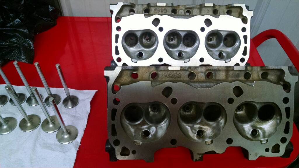

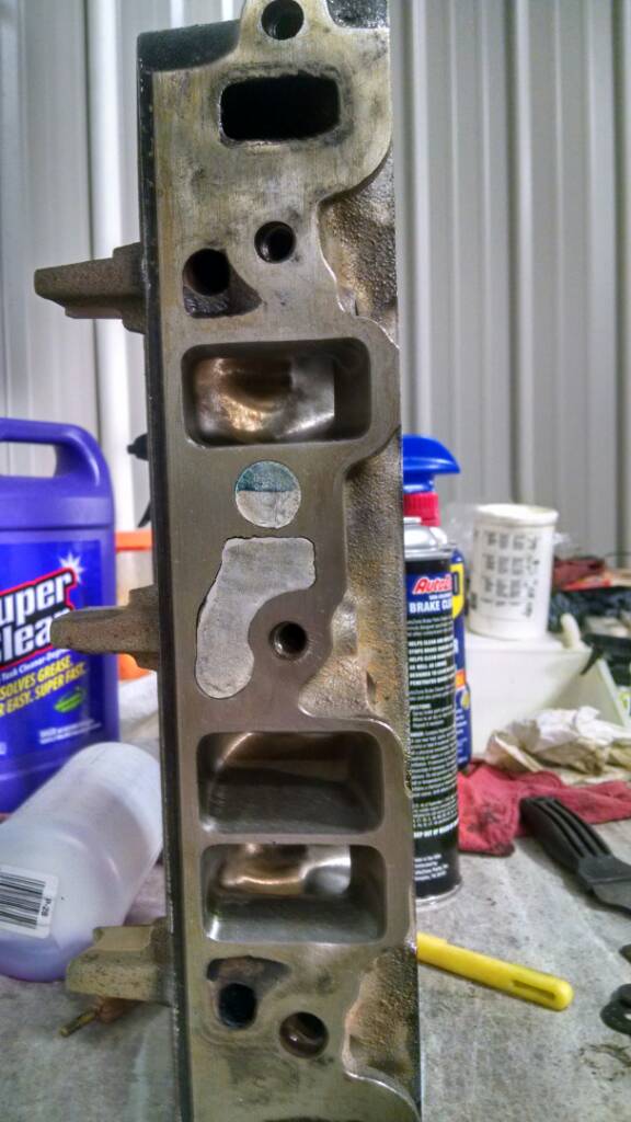

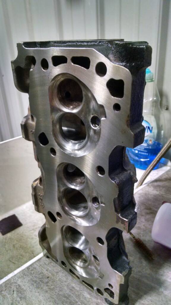

dont know the source but had this in my archives from many years ago
wish we would have flowed mine.
