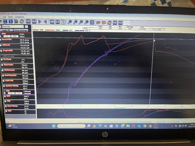

this is a screen shot of Locked and Unlocked
I let off at the 1000ft unlocked ,don't have a clue why.
Side note Holley saved my BUTT I was having fuel pressure loss and the Holley added fuel to keep me at my AFR and not lose the engine.
Fuel pressure was down on both passes but AFR was 10.5 all the way
My Schrader valve did not like E-85 and the plastic cover I used had no O-ring. I can't smell E-85 and it did not leak at idle,Im lucky I did not catch it on fire.
I have new cap with a O-ring and a OE cap no O-ring or should I remove the T and go 90 for the transducer? Should I continue to lock it?
