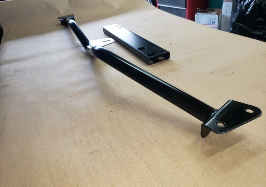

Project is still ongoing,
Got some linkage hardware, should be all I need to connect stock shifter as well as get the column collar / neutral safety stuff to work.
black bracket is from inline tube, silver stuff is Shiftworks. all part numbers will be in the build list when this is done.
