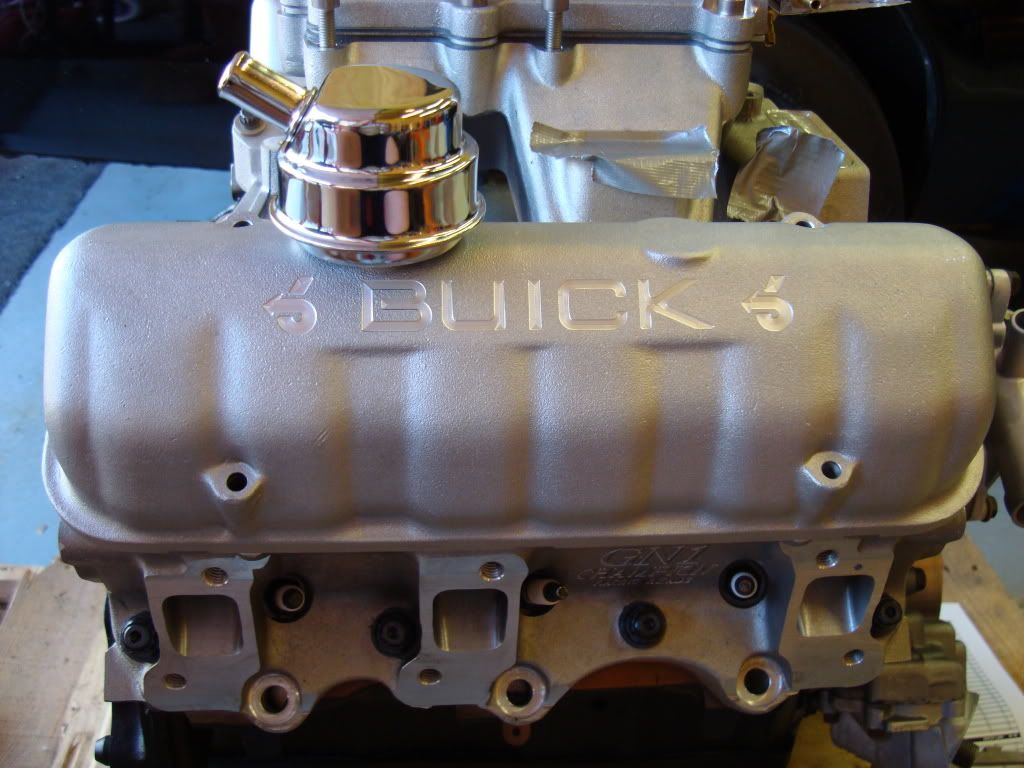

http://i233.photobucket.com/albums/ee193/mmiller25/2741.jpg
Above is a picture of the valve cover in question.

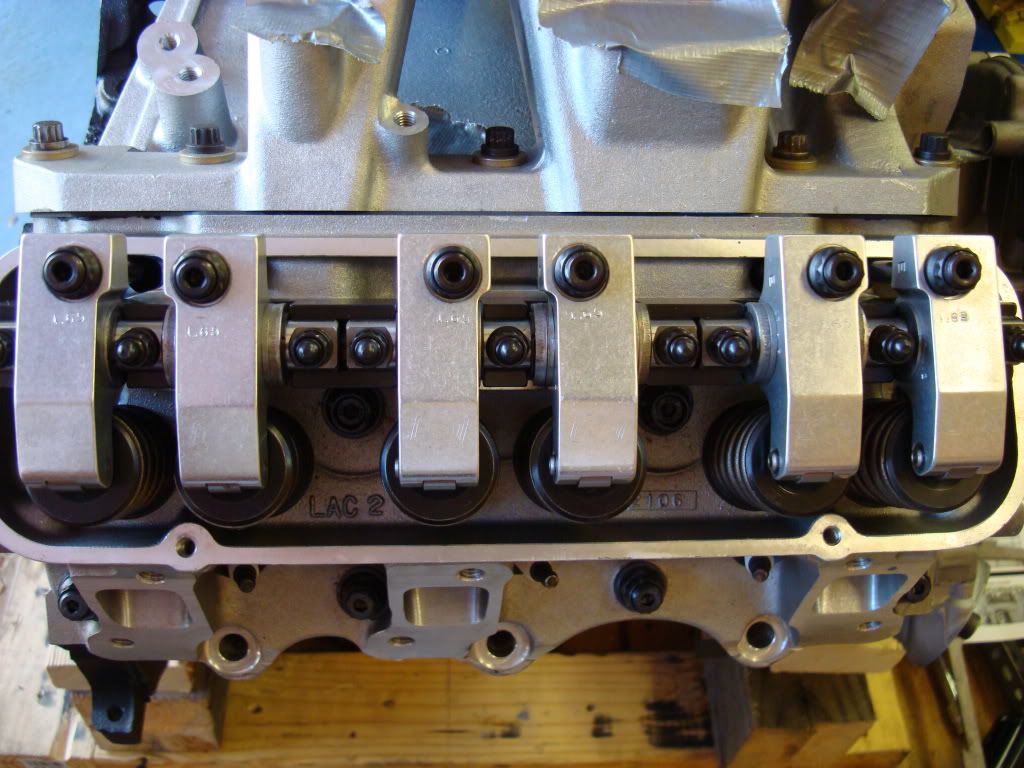

http://i233.photobucket.com/albums/ee193/mmiller25/27411.jpg
Above is a picture of the valve train setup.

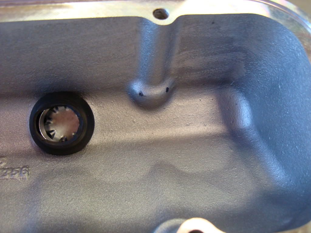

http://i233.photobucket.com/albums/ee193/mmiller25/27412.jpg
Above is a view inside the cover. Black shows the area were corner of the rockers are touching. This is happening only on the top side of the cover at each respective bolt location.
I am going to have to do some serious measuring to see if there is enough material here to be removed. Won't get to it today.
I ran the Champion GN1's (before they cracked) with the TA valve covers and did not recall Dan saying there were any issues with this. I want to say (from memory) that my rocker arms have a radius on the tops and yours are square.
did you have a gasket in place when you checked ?
a thicker gasket (doubled up cork) might work
clearancing the arms seems easier
What rocker arms did you use? Do you have any pictures of them. Maybe a little reshaping of the rocker is in order. Might be better than trying not to break through the valve cover while grinding it.

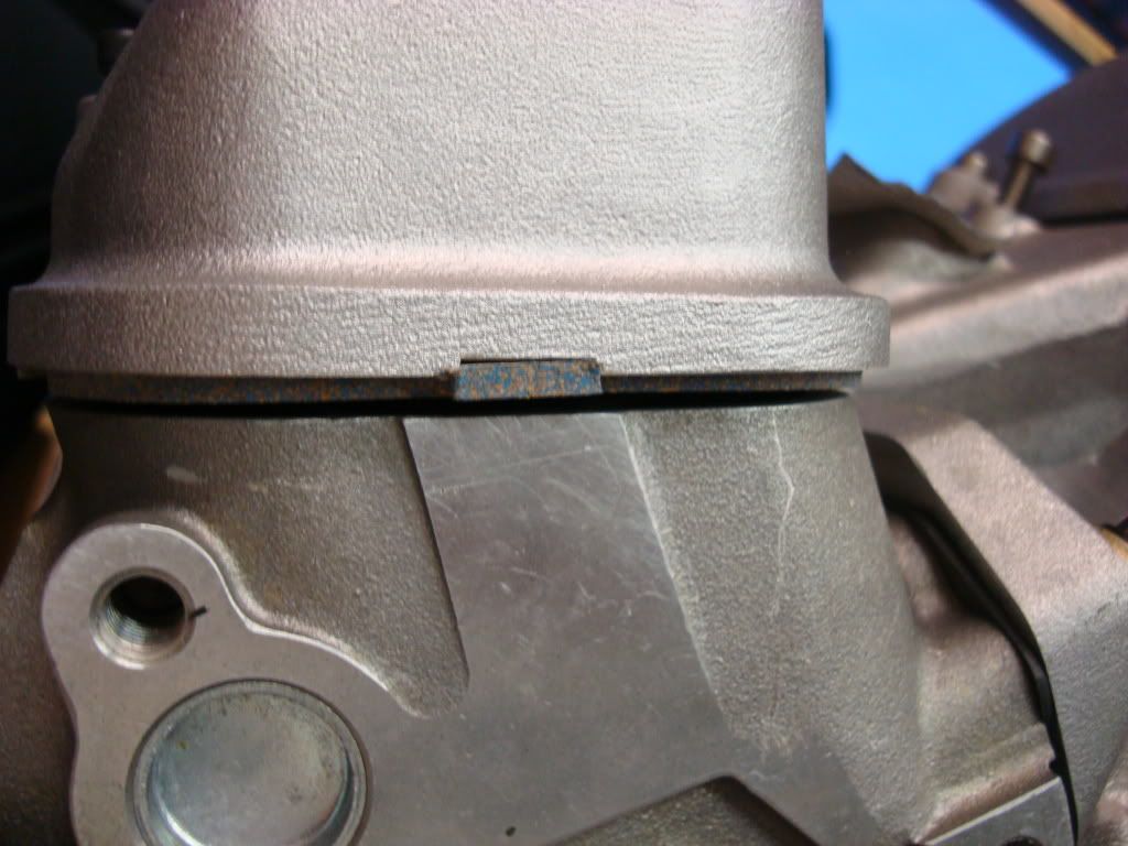

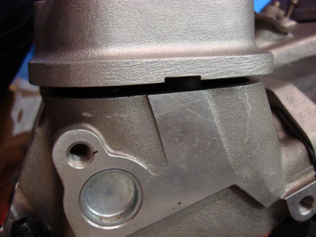

Here are some more pictures I took tonight. One is with no gaskets and the bolts started so that gap can be seen. The other is with a blue cork Fel Pro gasket and also bolts started. I bought the gaskets a couple years ago and cannot recall if these are the 1600 gaskets. Someone please chime in on that.
I am working this weekend but plan to work on this Monday and/or Tuesday when I am off.
http://i233.photobucket.com/albums/ee193/mmiller25/274001.jpg
http://i233.photobucket.com/albums/ee193/mmiller25/274002.jpg
1600s are 3/16 thick
looks like you're going to need to do a little grinding
try that rjc spacer with a blue gasket like you have, or put 2 1600s on there just for kicks to see how that looks.
I dont know if thats a 1600 it looks like it but all i know is if you buy a stock one $9.99 and put 2 together ,that may = the 1600 but even if it is just try 2 gaskets even if it is to see if it clearance.
I've been lurking through this post since it started so I'll finally put in my $.02. I see where it's hitting in the cover but where on the arm is it hitting? If it's just on one corner you could just shave a little off the corner without hurting the stregnth of the rocker.
