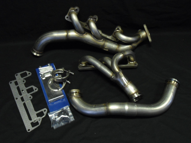

Best headers for the money IMO are the SE's that TR custom parts sells. They are similar to TA's and are made in the USA.

I'll be sure to put it on there.:) We sell both SE and KB style headers, I have the KB style on my own GN. Mine bolted on without any issues and have been on there for years now. Only mod I made was to have the crossover welded up. Like previously stated the main drawback on the KB style is that you are required to use a downpipe designed for this type of header as the crossover comes up into the motor compartment and occupies the space a regular downpipe would be.

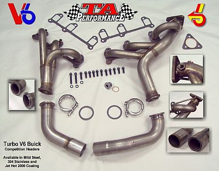

hello; Could someone post up a picture of a stock set off the car.
IBBY
hello people; If someone knows how to post all 3 header designs on the same page it would be real nice. I'm going back and forth trying to see differances and it kinda sucks. I think the stock looks much simpler than others. I do have the TA (not installed) but I'd like to see em togeather.

I bought a set of these mild steel TA headers from ArizonaGN about 7 years ago.
When we went to install them they would not line up properly and there was some drilling involved.
When I called to voice my concern i was told I must have gotten an set from the old design. o_O
After some drilling and fine tuning they do work fine and there aren't any leaks.
The only problem I come across, besides initial install, is when pulling the engine with the transmission still attached, you have you remove the passenger side header or it will not come out.

In the OP original post, my answer would be zero difference in your current setup. I have the TA SS headers and like them a lot. The only pain in the ass that I encountered with these headers are your starter selections. When I had my ATR's on the car, I ran it with a Hi Torque Lt1 starter. I got the TA headers and tried to use my LT1 starter and it would not line up. The pipe got in the way.
So I was forced in using the Crappy Turbobuick starter which crapped out on me twice.
Then bought a Hi Torque Starter from Dan at DLS to remedy this problem. So be ready to drop for a good starter out the gate if you go with the TA header.
