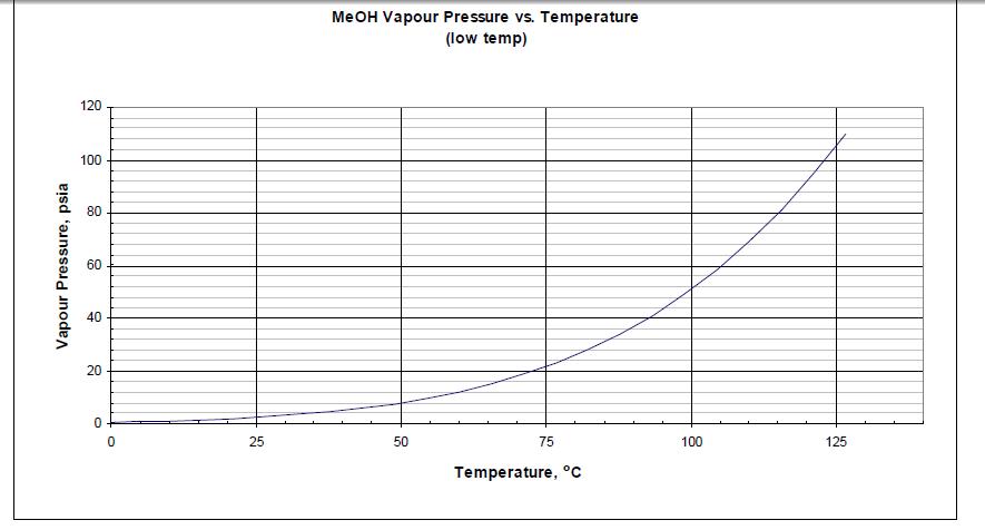

what temp does the air need to be when the meth enters the pipe in order to turn into a gas?
Psia (absolute) includes the atmospheric pressure of 14.7 psi at sea level compared to the psig we usually read for turbo boost.

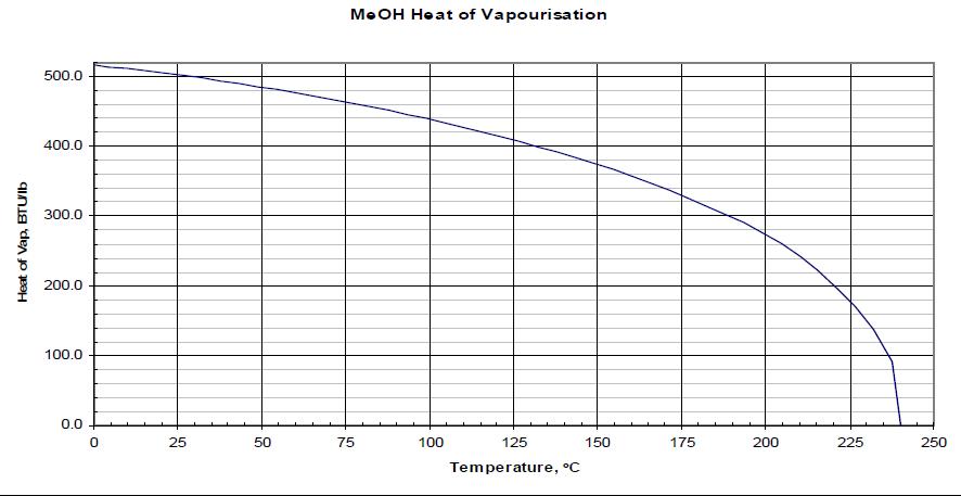

The graph is from: http://www.methanex.com/
Keep in mind the heat of vaporization of methanol would lower the charge air temperature considerably, so there is a possibility there could be vaporized liquid that would follow the path of least resistance into the rear cylinders. So cylinders 1 & 2 would be leaner.
