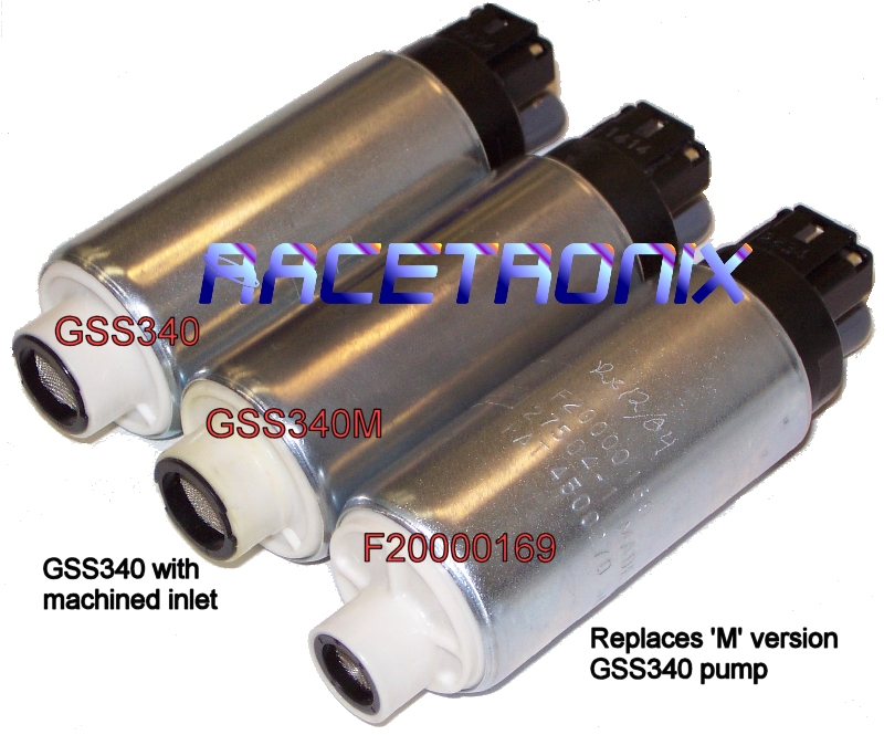

That's right, the 340M was the older pump and these are all new pump designs.
Fill is in on WOT pump pressure.
The only thing new about the F20000169 is its plastic inlet which saves Walbro from having to machine the ends of the pumps which they did for 15+ years.
It is very easy to tell the difference between a GSS340M and a F20000169 even if Red does grind the numbers off.
F20000169vs340

Thanks for the pic Racetronix.

Just in case anyone was curious, this is Red's XP pump I got a week or so ago from Cotton's. Looks like the GSS340 or GSS340M pictured in Racetronix post above (honestly I don;t know how to tell the difference or where the machining is). The pump comes with a rubber boot on the inlet end, but I removed it for the picture.
That looks like the 340M pump from Racetronix, with the enlarged/machined inlet. You need to slip off the foam rubber insulator from the pump to see the numbers/engravings...
