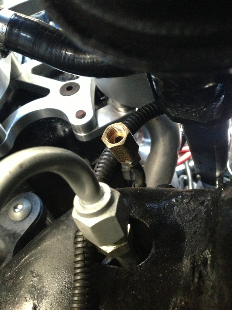

I cut my Saginaw fitting by the frame off ran a 5/16" fuel injected line to the regulator. The Pressure was at 50psi with no drop I had 128 on my BLM's. Im gonna try some new fittings on the FPR to eliminate the o ring and see if it will drop a bit more. This is after I installed a 340LPH pump from RX.

So, the lesson learned here, for me, is to install a larger return line with a 340 lph fuel pump. Info I wish I had prior to my adventures.

If the regulator is the problem,why did you replace the lines?
I'm on e85 so maybe it's different but I had a base of 50 to 55 psi with no control with a deatchwerks dw300. Tried drilling out all of the saginaw fittings with no results. Put in a new dash 6 return line and now I have full control of fp.
its not the reg, its the return, we usually upgrade the feed line and use the stock feed as the return, problem solved and both get an upgrade
