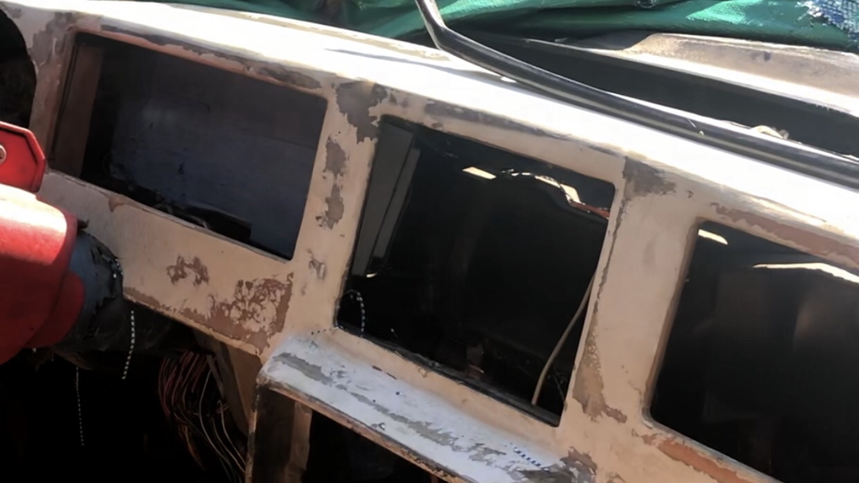

10” monitor all in one computer in the center. Tinted plexiglas on both sides of the monitor with blue digital gauges behind them. I took my gn dash out and put a 87 Monte Carlo dash in and got rid of the offset gauge cluster
It seems like you are way ahead of me . I still have to figure out a way to mount it you already have a nice dash setup ready for screens . You should check out the new LattePanda alpha. It’s badass and they have a 10” monitor that’s super clear and crisp.

Just a lil update I’m returning this screen and am looking for one that is brighter. As you can see in this picture it is dimmer then my laptop screen. So that won’t work when it’s in my car with the glare of the sun on it . I already have acouple other options I’ve been looking at .
