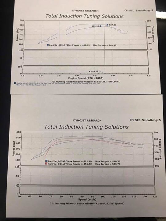

Here's a TA 49 on an engine with some light head work. Bowls cleaned up. Has a better stock location Intercooler than stock. This will run low 11's its on a stock converter and spools fast. Higher number after pulling 2* of timing and locking converter. Over 50lbs/min of air. A really good set of heads would probably get it up around 500whp unlocked. Manifold pressure would be in the low 20's. Running a 60-1 the most power I ever made with one manifold pressures were in the low 20's. The compressor isn't happy running high pressures. About 90* for these dyno hits

Would you be willing to share if it was a stock cam, compression ratio, and what fuel?

Cam is bigger than stock not sure what it is though, came with the car. Compression is slightly higher due to milling the heads a bit. 93 Alky, running a precision SLIC.

The cam is likely hurting the engines power with the drive pressures you had. Remember the initial hit with the wastegate swing valve disconnected it was within 30hp of the highest we got all day unlocked but at 5500rpm. Once we got the turbo all in down low it lost power at high rpm and picked up power down low. Which is why the converter is so important in these cars as the turbo starts to get worked. The harder the turbo is worked the tighter the converter And taller the gearing typically. I'd suspect exhaust pressure on the last hit was over 65psi and probably closer to 70psi at 5200+. All that exhaust pressure dlllutes the intake charge and it takes several degrees of crankshaft rotation for positive filling of the cylinder to start on each intake stroke. Same effect as egr and reducing the camshafts useful duration exactly when you don't need it. There are also pumping losses encountered pushing against that high drive pressure. This is why peak power shouldn't be of the most concern. You could put an MFS 6262 on there and probably only pick up 40whp peak but it bet my junk it would pick up over 100whp at 5700rpm!
About 2 years ago I switched a 6466 to an MFS 6766 and only picked up about 40whp peak at about the same pressures but the 6466 was falling off a cliff at 5700rpm. I increased manifold pressure further and peak power went backwards. With the MFS 6766 it was up over 100whp at 6000rpm and this car needed all the breathing room it could get. I didnt test past 6000rpm but I'd bet it would have been up 150whp at 6400rpm

We can't come to any real conclusion about the CR other than it was more than it was before it was "cleaned up". A little in the gasket being that it was .010" thinner and 3.86" bore vs 4.020" and a little less in the milling of the heads from .014" removed off them. We don't have the piston dish or how far down the piston is at tdc. Probably around 8.3:1 CR at best as a guess
